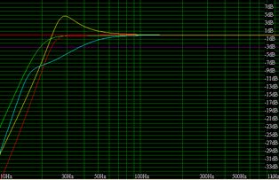

CBFryman
01-20-2005, 05:25 PM
28Hz bottom Heavy? Nah.... 15 will do... lol.
But seriously 28Hz with some drivers is WAY to high and with others is WAY to low. Example (im so happy now that i figured out how to post responce charts)
Adire Audio Tempest (Fs 18.8Hz)
Digital Designs DD3015-4 (Fs 34Hz)
Green: Tempest 283.5l 19.46Hz Tuning
Red: DD3015 411l (humongo) 26.22Hz Tuning
Yellow: Tempest 411l 26.22Hz Tuning
Blue: DD3015 283.5l 19.46Hz Tuning
http://img.photobucket.com/albums/v201/CBFryman/12A.bmp
Granted this is in an open evitonment and cabin gain in a car will give substantial standing waves...but it looks pretty on paper.
sr20de4evr
01-20-2005, 05:49 PM
hence my above comment:
ported is best for home where the flat anechoic response resembles the actual in-room response very closely. You stick a ported box in a car and the cabin gain will screw it up royally.
that flat anechoic response that you just found in WinISD is the same one that I was talking about here, you stick that in a car and you'll get a ~12dB/oct rise starting at the resonant frequency of the car (55hz or so). With a sealed box, this basically cancels out the 12dB/oct drop in response that starts at the F3 of the sub/box combo (around 50hz, depending of course on the specific sub and bo) and you wind up with a pretty flat result. But if you take a sub/box set that's almost perfectly flat already and you stick it in a car, you'll wind up with an incredibly bottom heavy result.
