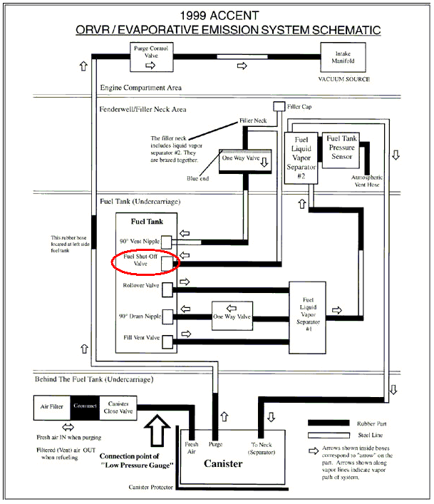

I would guess that either your fuel cut off valve is not working properly or your fill vent vavle is not letting vapors escape see enhanced emission diagram for your model on the webtech site for diagram......or if the fill vent valve line was plugged/pinched it might cause this.

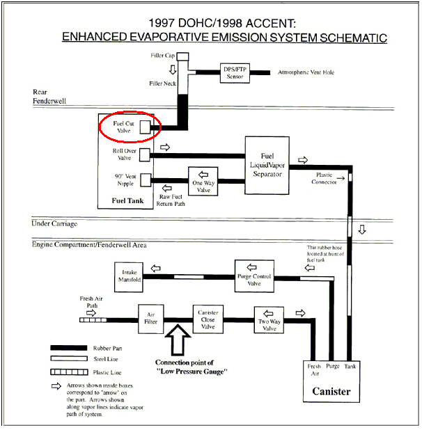

If you do indeed look at the schematics (http://www.hmaservice.com/webtech/iindex.asp?id=394875417#_394875417), you will see that the 1997-1998 Accent does have a Fuel Cut off valve located within the fuel tank, see diagram below.
http://www.santafemods.com/images/Other/ForumPics/AFStuff/97-98Accent01.gif
The 1999 Aceent also has one, but its labeled Fuel Shut-Off valve..
http://www.santafemods.com/images/Other/ForumPics/AFStuff/99-99Accent01.gif
The 2000-2001 accent also has the Fuel Shut-off valve..
http://www.santafemods.com/images/Other/ForumPics/AFStuff/00-01Accent01.gif
Apparently Hyundai is using both name decriptions for the same part. They just changed its naming after the 1998 MY. Proof of that is at the bottom diagram for the Santa Fe. It shows the name label of "Fuel Shut-Off (cut) valve".

I reccomend you take it in to a qualified hyundai tech. They will hook up an evap tester and verify the leak so it is repaired correctly. If it is a valve on top of the tank than the tank will need to be lowered/removed for repair. mske sure you tell them of your original problem to
