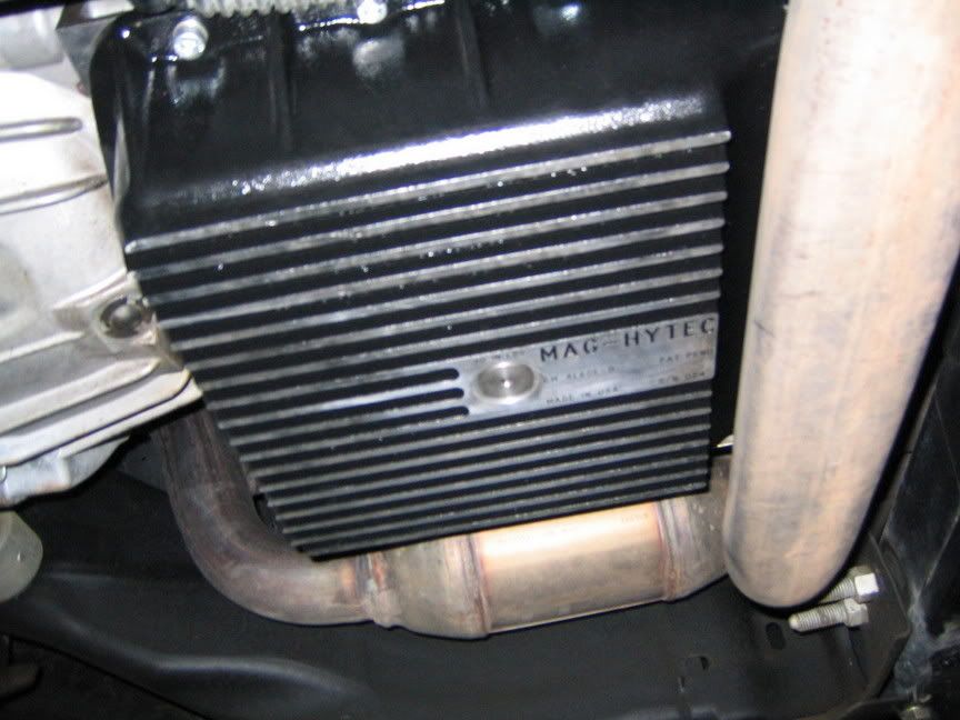

I had the same problem. I stripped the drain plug to heck. I ended up drilling a hole on the bottom to drain. Then I installed one of these, no problems no more.
http://img.photobucket.com/albums/v17/stevev/truck/trannypan.jpg

Oooo, those are niiice! Pretty spendy though if I remember correctly.
