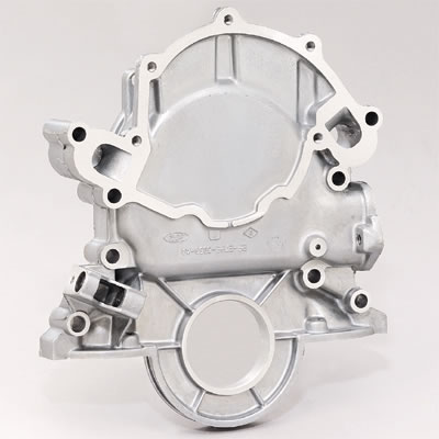

Also, clevelands have a different number of valve cover bolts. Clevelands have 8 while Windsors have 6. Another way is the windsors have a bolt on aluminum timing cover, while clevelands have the cover cast into the block with a plate(piece of thick sheet steel) as a cover.
Windsor:
http://static.summitracing.com/global/images/prod/large/fms-m6059-d351.jpg
If you don't have that big aluminum part on the front of the motor, you have a cleveland. Hope this helped.
