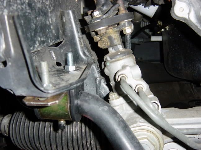

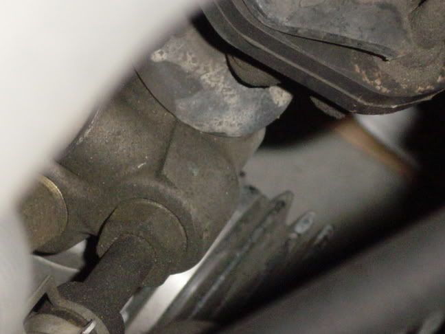

Hmm, seem to be having trouble finding that thing.
Here are some pics. Here's what it looks like from above.
http://img.photobucket.com/albums/v332/Alin10123/DSC00375-1.jpg
http://img.photobucket.com/albums/v332/Alin10123/DSC00377-1.jpg
here's from below what i see.
http://img.photobucket.com/albums/v332/Alin10123/DSC00381-1.jpg
http://img.photobucket.com/albums/v332/Alin10123/DSC00380-1.jpg

Ok great pics bud.....brand new front sway bar bushings with new *too*long bolts didn't fix it huh???Just kidding..prolly needed the better ones anyways lol.
Anyways...- your vehicle has *rack and pinion* steering(2 front tires,spindles,outter tie rods ends and the rack and pinion is what is inbetween that your steering colum attaches to via a rubber coupler which you can see clearly in last pic)......the loose rack bolt refers to the rack and steering assm. bolts that bolt it securely to frame...
Check all your bolts that fasten your rack and pinion steering assm. to frame/crossmember and remove,clean,apply blue loc-tight on threads (availiable at autozone) and re-install all fastening rack to frame/crossmember bolts to prevent them from *walking out* on you again
Check that rubber coupler that joins colum to rack as shown in last pic for slop and replace as nessasary....goodluck and let me know bud.

Actually... in regards to the swaybar bushings bracket, if you look at the last pic where you can clearly see the 2 bolts. One is kind of shiny and one is dull. The dull one is the original bolt that came fromt he factory. So... i dont know why they made it so long. But i figured there was a reason, so when i bought the new bolt, i just matched it.
Anyways... i think you hit it right on the spot. I went into an independant shop today and the guy put it into the alignment rack, He then turned the steering wheel and i could physically see the entire rack move. There was also a little clicking sound coming from the left side and when i put my hand on the left rubber boot, the clicking was coming from there, the mechanic said that the left tie-rod may be worn as well.
So... any source for parts? I was thinking about replacing the rubber with polyurethane since i did that with the sway bar bushings with energy suspensions and the truck felt a lot more stable in turns. Not sure with the steering rack, will it be back for the ride? Or will they squeek? As long as they are greasable and that will stop the squeek, that will be ok i guess.
Will this be a simple replacement for the two bushings on the steering rack? Or will i need a lift/special parts? It looks like i just take a big wrench and loosen the nuts, and so forth. But i just wanted to confirm. Also, how hard is it to change the left tierod?
