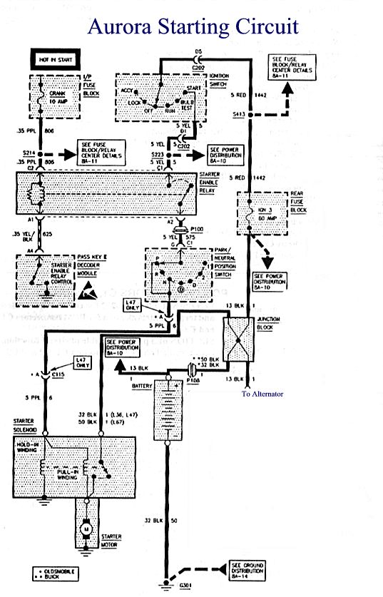

I haven't had the problem, looking at the FSM schematic gave me some thoughts. There are actually two relays that must activate to turn the starter. The first is controlled by the pass key decoder, it's called the 'starter enable relay'. It's on the LH side of IP on a bracket left of the steering column. This relay can be faulty and not give you the 'key alarm', it's after the key decoder. This relay supplys power to the neutral safety switch which in turn supplys power to the starter solenoid. So, when you say there is a relay click, which one? If the internal relay is clicking try starting in neutral in case the safety switch is going bad.

If the 'outside' solenoid is always engaging and is known to be good then the trouble is not with the key or other 'inside' components, you are either lacking:
1. voltage to the starter ( check the cable, there may be a junction block along the way from the battery)
2. a good ground (engine block to chassis)
3. or the starter or solenoid itself is defective

I hear you, for the last two years I have vowed not to replace any parts that are not verified bad, so far so good. If the solenoid is giving a loud click the neutral switch has to be good as well as the key and switch. You should check the power lead to the starter. Trace it back from the starter to the 'underhood junction block'. This junction block is located on the RH side of the engine compartment at the front of the RH strut tower. The positive battery lead winds up at this junction block and connects to the starter, alternator & also feeds the underhood relay center. Pay attention to the starter lead at this junction, might be loose or corroded.
PS : Link to schematic http://www.retrocom.com/AuroraStarter.jpg

Electrical problems can be frustrating to say the least. You need to break into the circuit somewhere and start taking voltage measurements. I suggest the middle, measure the voltage during start (hold) between park/neutral switch (terminal G) and ground. The switch is located on the LH side of the transaxle.

voltage needs to stay above 9.5V when attempting
to crack, at all measure points. If it doesn't, check for
bad connections in the +12V and GND lines.
If the battery voltage stays above 9.5V, then measure between
the GND connection of the block to the chassis (passenger side
- engine front) to the battery GND terminal. This will take
some long wires, but since measurng volts takes no current
in the wires, it won't affect the reading. The difference between
the GND at the engine and the GND at the battery needs to be
less than 0.5V. If it is more than 0.5V, then check the GND
cables for a problem. Once they are OK, proceed.
Do the same type of measurement, but between the underhood
junction box +12V and the starter solenoid B+ terminal. Have
someone attempt to crank for 15-seconds. This voltage needs
to be less than 0.5V. Again, if it is too high, then check the
cables and connections involved.
Basically, think about where all the high current is going to
flow when the starter motor is put into the circuit and look
for voltage drops that are too high. The amount of current
involved is a lot, and there will always be voltage drop through
the wires due to their resistance, but the connections at these
locations listed are the primary spots that can effect
the voltage drop a lot.
The solenoid itself can work with lower than 9.5V, but the
starter motor very often will not turn at all at or below 9.5V.
I hope this helps...
GuMan
