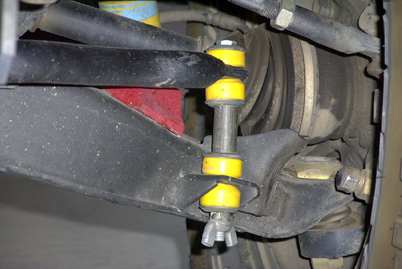

update this with a picture of my quick disconnects I made that include longer spacers to level out the sway bar angle.
