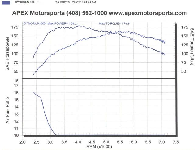

Here's some dynos
A stock engine 3s-gte with an upgraded CT-26 @ 17psi (E-153 M/T looses 18% - 324bhp)
A-pex blow off vlave
upgraded fuel pump
stock inetrcooler
550cc fuel injectors
TKO 2.5 exhaust system
Stock motor.
boost controller.
Aem cam gears
Ems system
http://img233.imageshack.us/img233/203/dynoresults9ne.png

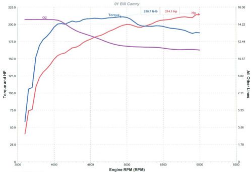

1mz-fe + 3.0L TRD Supercharger @ 4psi (No tuning, no mods) (looses 22% in the A54X A/T - 235bhp)
http://img.photobucket.com/albums/v414/Toysrme/Data/4psiTRD.jpg
VS
1mz-fe + 3.0L TRD Supercharger @ 4psi (SAFC tuning)(looses 22% in the A54X A/T - 256bhp)
http://img.photobucket.com/albums/v414/Toysrme/Data/01camrydyno.jpg
1mz-fe + 3.0L TRD Supercharger @ 6psi (Headers, cat back, SAFC) (looses 22% in the A54X A/T - 303bhp)
http://img.photobucket.com/albums/v414/Toysrme/Data/6psiTRD.jpg

3s-gte stock dyno (E-153 M/T looses 18% - 192.34)
http://img.photobucket.com/albums/v414/Toysrme/Data/3sgteStockDyno.jpg
Not saying there is a right, or wrong thing to do, but the v6 swaps are going to be cheaper. For the same cost as a 3s-gte swap (Which isn't including the cost of a new transmission), you can:

Here's some dynos
upgraded fuel pump
stock inetrcooler
Stock motor.
boost controller.
Aem cam gears
Ems system
VS
