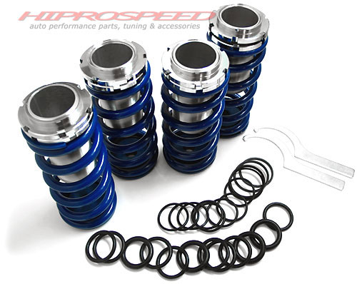

if ur building a nice ride and want coilovers...then reread this
most people don't know that every time you adjust ur height ur SUPPOSED to get an alignment...but that's why itz better IMO...but not cheaper to get a real coilover set and not sleeved adjustable springs...
sleeved adjustable springs:
http://images.channeladvisor.com/Sell/SSProfiles/60000032/Images/coilover_new.jpg
true coilovers:
http://tein.com/img/ss-ek1.jpg
Proper setup with adjustable height springs is something overlooked or even unknown. With slight adjustments you can move pounds around so the whole car is equal or however the driver prefers(60/40 40/60, etc.) Every time you change the height corner weighting should be done & an algniment is needed. That's why I say coilovers are overkill for street use.
true coilovers:
