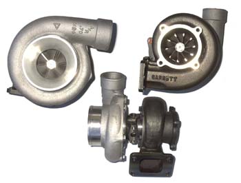

http://www.jimwolftechnology.com/images/TURBO_GT3540_SMALL.jpg
El spooge...that bad boy blow enough air for ~620hp out of my 300ZX... :devil:

A well designed turbo *system* will always have the potential to outperform a S/C. Get properly sized piping, a properly sized I/C and a turbo with the parts you want and you'll be able to tune it into oblivion. The turbo alone has hundreds of different configurations. The multitude of different compressor housings, turbine housings, turbine wheels and compressor wheels make the combinations very vast. You want a quick spooling turbo? Get one. You want a mega-power turbo? Get one. You want one anywhere in the middle? No problem. You'll get better gas mileage, better efficiency and easier adjustability. Wanna turn the boost up or down on a turbo? Turn the knob on the boost controller...done. Wanna turn the boost up or down on the S/C? Bust out the tools. The only thing the S/C has on the turbo is the reduced lag. I've seen turbos make boost at idle, so there goes that. A well designed turbo system will have very little lag...if any at all.
I know there are a LOT of people out there that will swear up and down that S/Cs are the best thing since sliced bread...whatever...have at it...I'll take a turbo any day. Read the "Turbo vs. Supercharger" thread in the Forced Induction section of the Cars in General forum and you will too.
