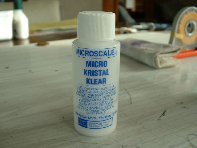

Always use 'white glue' which is a water based glue that turns clear once it is dry.
Microscale makes a good glue called Krystal Klear.
If you mess up with it you just wet it and wipe it off.
primera man
10-09-2004, 04:25 PM
Test fiit the parts first to make sure they fit correctly then add a small amount of this glue here (kristal clear) to fix your problem.
It dries clear and wont stuff up the plastic.
http://img.photobucket.com/albums/v60/1PMan/Kristal_klear.jpg

Got another hint. Make sure the clear part and the place of the joint are free of any kind of dirt. Especially fingerprints. Fingerprints will turn even the clear glue white. I'll get MicroScale Krystal Clear as well, as I still need some waterbased glue. Thanks guys and good luck.
