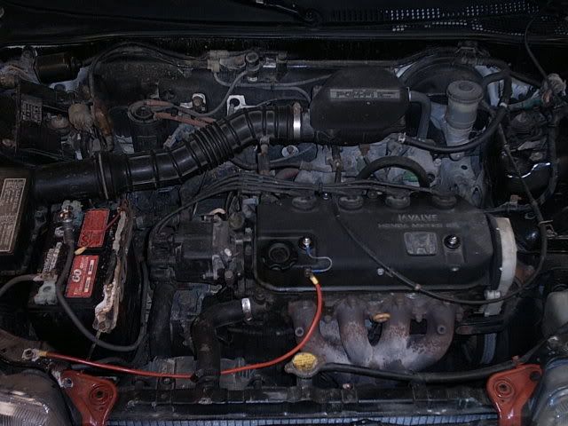

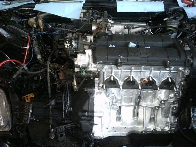

OK i started with a Stock 89 CRX DX at about 88 HP...so first thing was adding the ZC engine...
Before
http://img.photobucket.com/albums/v51/Left_E/CRX/Picture_025.jpg
http://img.photobucket.com/albums/v51/Left_E/Boost%20Motorsports/Picture1_003.jpg
after
http://img.photobucket.com/albums/v51/Left_E/CRX/Picture1_042.jpg

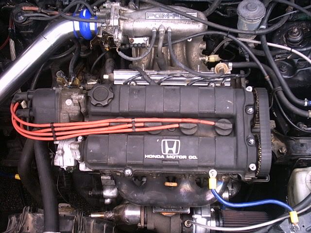

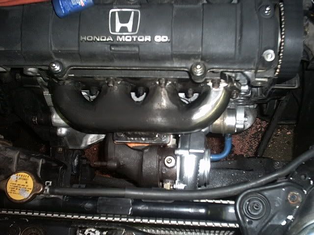

Then after i got the ZC installed the novelty wore off fast so we had add some HP Fast, So then we added a GT17 Turbo...
http://img.photobucket.com/albums/v51/Left_E/July11/July11_036.jpg
http://img.photobucket.com/albums/v51/Left_E/July11/July11_049.jpg
and so far i got down to 14.222 @ 102 MPH in the quarter and still tuning.

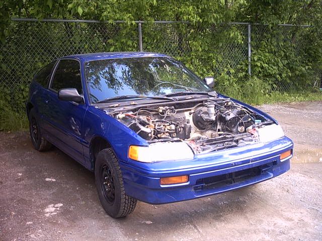

and this is how is sits right now...
http://img.photobucket.com/albums/v51/Left_E/CRX5.jpg
http://img.photobucket.com/albums/v51/Left_E/CRX6.jpg
we totally stripping thecar over the winet and doin a full rebuild..

i like the color, what supporting mods you got for that turbo?
Left_E
09-21-2004, 09:24 AM
Got an FMU, Irridium spark plugs, Synthetic oil, and the intercooler. The engine is totally stock and it runs excellant takes all even at 10 pounds of boost...

running 10psi on an FMU with no timing management is a bad bad bad idea. even with a small 8psi disc in your FMU, you're running well over 100psi of fuel pressure in a system designed to handle just over 40psi. In addition, you have no timing retard, and so there is about a 90% chance you are detonating. detonation kills engines.
get some real management, or atleast an MSD BTM and pray that nothing happens from such high fuel pressure (i spy a redrilled 92-95 fuel rail)
the bottom line is that FMU's are complete crap, but it looks like you would have a very potent setup if it werent for that.
