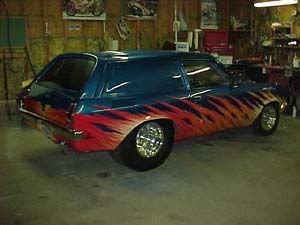

Thanks....Ive always played with my cars and its about my only hobby other then collecting NASCAR.Here is a pic of one of my many toys/projects I use to have
http://img.photobucket.com/albums/v285/BIG-L/KillerVEGA.jpg
and I started back in 71 with my first car being a 63 Impala SS with a 409/425HP and they had put a old straight axel in the front end (it was cool to lift the front end back in those days) and fender well headers a dual carb set-up on it.Then moved into the MOPAR scene with a 69 Dodge Dart with the 340 4 speed ,69 Roadrunner 383 4 speed,70 Cuda 383 4 speed and lots of other cars inbetween then and now...and im now working on a 83 Trans/Am that ive got and I just got my crate motor from GM that is a ZZ383/425 and im waiting on a rear-end from Currie enterprisise that is a 9in ford that will bolt in with disc brakes and 3.91 gears with a tranny out of a wrecked 98 Z28 6 speed....im the 2nd owner of this car and it only has 82,000 orig miles on the car...well enough rambling as I could go on and on.Have a great day !........~Larry~
