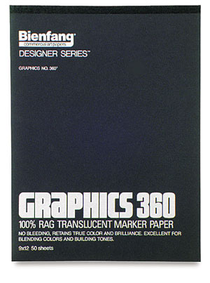

wait this stuff is called paper for markers...it's almost like tracing paper. We used to use it in art school all the time. hold on.....
This is the stuff!!
http://www.dick-blick.com/items/106/04/10604-OA3ww.jpg
http://www.dickblick.com/zz106/04/products.asp?param=0&ig_id=930
It's really really cool.
The translucency is awesome because you can transfer with it then render a real tight comp. It also cuts real easy with an x-acto so you can piece stuff together...once agin I refer you to Bonz on this. He knows what I'm talkin bout here.

oh.....
A lot like gesso-ing
on this paper you can push the color around to a certain degree. There is almost no "capillary action" (that's I went to art school in the late 80's talk for "bleed"), and it comes in big sheets.

09-01-2004, 10:58 PM
Hmm, ive seen beinfang marker paper, but not that before. I guess ill have to take a trip over to dick blick and check it out..
Also ive never heard of using bestine before. Its like a thinner right?
