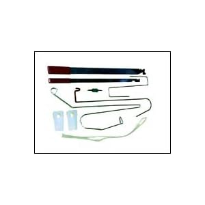

PS lockout kits, like tow drivers use, have a nice little plastic wedge made for this purpose....see if you can borrow one maybe, or even buy one, try Harbor Freight maybe....

You could also try a slim jim,...most older imports, because of how they unlock if you pull the inside door handle, will simultaneously unlock and open when you hit the right spot with the 'jimmy.
http://www.amazon.com/Slim-Jim-Lockout-Tool-Set/dp/B0002TW2IC
http://ecx.images-amazon.com/images/I/215ANXED1DL._SL500_AA300_.jpg
Here's an entire lockout set with wedges, slim jims and wonder rods for $19...in fact I'm gonna buy one now that I think of it...used to have all that stuff.
If your doors are the type that unlock when you pull the interior handle, I know I could pop it with a jimmy....and the wedge allows you to see what you're doing in there, without fighting the weatherstrip.
And the rods will work to snag the latch release lug and pull/push, if it comes to that.
If it sounds overwhelming, when you get the wedge, use it and flashlight to look inside your working front door while you operate the lock and latch. You'll see how it works, and be able to determine how to release the bad side...
Many times the rods pop off just because a small retainer clip drops off...if this is the case, replace all of them on both rods, or you'll be doing this again, probably.
