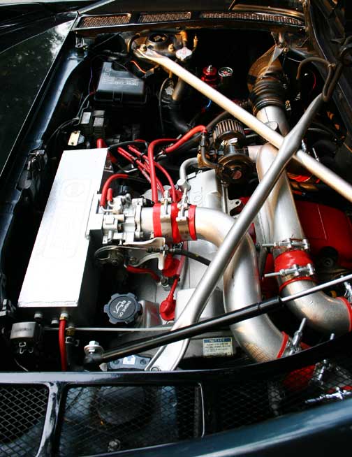

This will be my last bit of engine dress up for a while.
I painted the heat shield red ~ hadn't had one on in 3 years.
I also rewrapped the downpipe. You can see the opening for hte LM1 wideband cut into the heat shield.
Newly powder coated is: RMR intake manifoldr, throttle body, throttle cable bracket, custom K&N filter adapter, turbo inlet pipe and the PCV pipe under my little K&N

drazhartd
07-22-2004, 01:12 PM
Wow.
One more time...
Wow.
Hey, what's that mini intake ya got there?

JekylandHyde
07-22-2004, 01:17 PM
Thanks ... not sure which one you are refering to.
I have three K&N air filters.
I have a huge one on my actual intake.
I have one on the end of the PCV.
And I have one on the OEM BPV valve.
I was calling it me "K&N Triple Threat"

drazhartd
07-22-2004, 01:28 PM
I've never seen that done before, especially on an mr2... what kind of hp gains or advantages did you notice after adding the 2 extra little K&Ns?

JekylandHyde
07-22-2004, 01:35 PM
The one on the PCV, does not directly add any real "power" ... it just stops dirty air from the engine from being circulated back into the intake.
The one on the BPV offers absolutely no benefit other than it allows the OEM to make the "cool BOV noise". You can ONLY do this mod if you have a VPC or EMS .... something that gets rid of the AFM.
