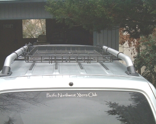

These pictures show how I dropped a Nissan safari rack between the rails. Just a quick and dirty using U bolts and book shelf HD supports running underneath the rails to support the rack. I used hose clamps (covered with black tape) to fasten the rack to the supports.

Nice workman-ship! It does not look home made at all.
