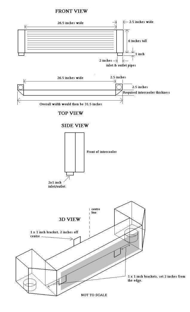

Hey thanks for that Brian, ive already had a reply from Wayne @ Forge and this is what ive sent him. Hes quoted me £270+VAT which isnt bad at all. I measured the space available and this is what ive come up with.
http://files.automotiveforums.com/uploads/269119intercooler2.1.jpg

ales - Ive already got some custom cams in, and they'll be staying in, cos i aint got the std ones anymore.
The intercooler will be located between the bumper and radiator. Theres a brace/bracket that goes fron the cross member to the front bumper which houses the air bag sensor, well the intercooler will sit below that brace. Thats why its only 6 inches high. But now, ive managed to get a price for a 80mm thick intercooler which should make up for the lack of height. Heres a 3D view of it.
SITE UPDATED!!
http://files.automotiveforums.com/uploads/922120intercooler3D.jpg
SITE UPDATED!!
