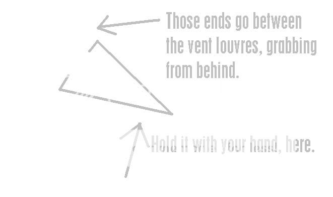

Malibu- I can change a radio in under 8 minutes, but I've done this about 20 times. first, remove the woodgrain trim alll along the lower dash. This trim hides some screws. Before you take those out, bend up a wire clothes hanger so that it looks like a "V" with little bends on the end, and use it to remove the air conditioner vents. Each vent conceals a screw. Remove all of the screws holding the black upper trim in place, and it will pop off like the lower trim did. Now you have access to the radio. I'd reccommend a delco CD player, they are very strong units. Good luck!

Malibu...turn vents fully in one direction, push down on top edge sticking out...no nasty scratches from wire implements. Side vents are specific, centers are the identical. Try putting gearshift in neutral(with parking brake set!) before removing black trim.

PAman, Let me explain my tool better.
http://img35.photobucket.com/albums/v105/tman2093/Random/tool_copy.jpg
I suppose your way works too though. I'm all about using tools.

Sorry Tman, hope I didn't offend! When I use tools on the plastic stuff in cars, it seems to increase my tendency to break them...

No offense taken, I just thought I didn't explain my tool well enough. I never considered just using my hands like that...
