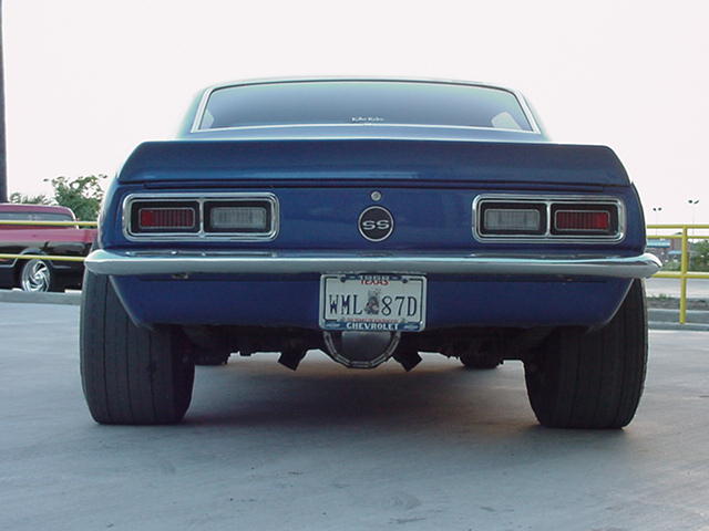

tacoma man
05-11-2004, 11:38 PM
are you tail lights like these?

tacoma man
05-11-2004, 11:40 PM
id say they are too, i'd say it is a SS and
the 327 ss is rare, worth $20-30,000

those are the taillights

96CamaroSS
05-12-2004, 02:22 PM
Well the only way to tell if the car is a real SS in 68 is to have a copy of the original build sheet, broadcast sheet, or protecto plate. There is no way to tell by looking at the headlights either. Seems like you are getting information thrown in that is not right. SS taillights are not any different than the ones that came on a standard 6 cyl car. Only the RS came with different taillights and headlights. 350 was the smallest engine availible on a SS car in all the first gen cars. Check the engine to see if the numbers on it match the cars vin...

You can't tell an SS from a non-SS by the headlights or the taillights. However, the taillights will usually tell you if it is a true RS (Rally Sport) or not. If the car has the hidden headlights (the doors that cover the headlights), then this is consider an RS. Bear in mind that you can have a combination RS and SS.
if the taillights include the white back-up lights, then this car is not an RS. RS cars had the back-up lights in the rear lower valance. if the car has hidden headlights, but standard taillights, then there is a good chance that someone converted the headlights to RS.
The SS could have come with either a 350, 396, or 427 engine. The easiest way to verify is to check the stamping on the engine block (I believe it is the one on the right front pad, in 69 they were at the back near the filter). The numbers should match the past part of the VIN of the car (if it is a number matching car).
Also, make sure that the VIN designates this is a V8 car. The first 3 digits of the VIN should be 124 (123 is a 6 cylinder and NOT an SS).
Also, some SS's had a different hood with 2 vents on either side. However, this could have been swapped out since they are available repro.
