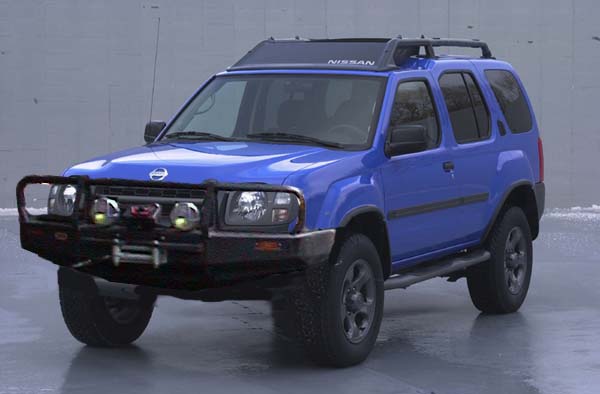

ozxterra
01-15-2002, 09:51 PM
Looks like it might be a little more work to install an ARB on a new X. You gotta remove all that extra stuff. The setup of the hood is also a good argument not to get a regular "Brush Guard." After what happened to Bluztraveler on his '01 I wouldnt want any impact on that fancy new nose the '02 sports.

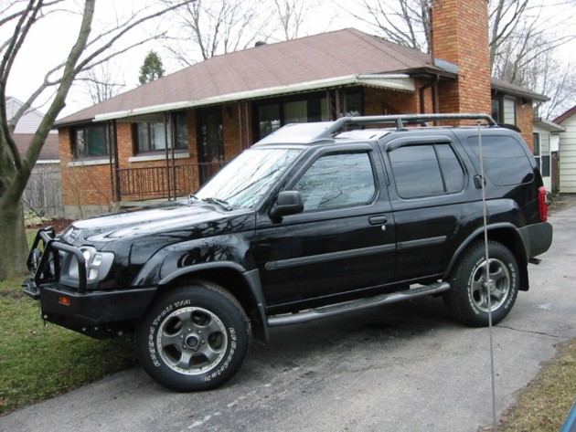

SarnX
03-09-2002, 10:35 AM
http://files.automotiveforums.com/uploads/600937frontclose.jpg
http://files.automotiveforums.com/uploads/530998frontangle.jpg
Excuse the driveway I am still searching for some mud around Sarnia. But since it is not supposed to be a shot of my X I assumed it would be OK.

Schludwiller
03-09-2002, 04:17 PM
Just a area to watch for. Because the ARB is mounted to your frame it will vibrate at a different rate than your truck body. If there isn't much space where you cut the plastic you will probably have some impacts between the two parts. It might not be a big problem, but keep an eye on how much the ARB moves the plastic front and possible rubbing of painted sections agains the vibrating plastic.
You'll noticed this most on the washboard roads and offroading.
