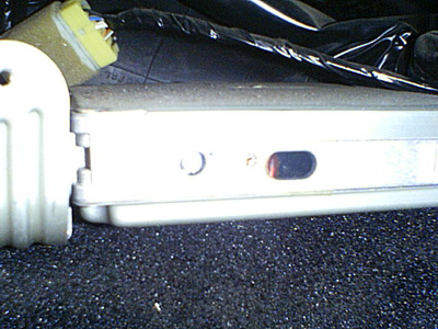

ronnie_g
04-01-2002, 12:40 AM
You mean this pain in the butt light? I got rid of it by following the manual on how to reset and check the fault code on the ECU unit. First, find out the fault code on your ECU. Then keep trying at least 3 times if the code will remain the same on 3 trials. I thought I had to change my EGR valve because it gave me the code for it. I tried the 2nd time, it still was code 32. Then, after the 3rd time, the code went to 55 w/c was freakin' normal. So, after that 3rd trial, the light was gone!!! This freakin' light went on for about 3 weeks! Maybe it was a matter of luck for me, but try it!
http://files.automotiveforums.com/uploads/305062CheckLight.jpg
G20t ECU:
http://files.automotiveforums.com/uploads/375822ECU3.jpg
G20t ECU:
