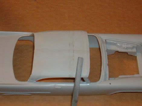

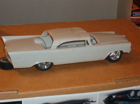

To make the glass fit easyer you don't want to change the angles of the pillers. The beas and hardest way is to cut the top into at least four pieces. I gust chopped a Chyrsler 3000. Here's some pix, I hope they help.
Mark
http://img.photobucket.com/albums/v25/650Mark/makxpix/IM002674.jpg
http://img.photobucket.com/albums/v25/650Mark/makxpix/IM002667.jpg
http://img.photobucket.com/albums/v25/650Mark/IM002689.jpg
