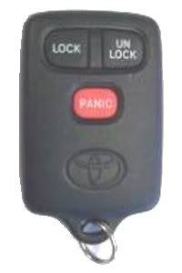

Camry didn't get the GQ43VT14T remotes until 2000. The remote you have (BAB237131-022) is for the Dealer/Port installed system. If you require the factory remotes, you need GQ43VT7T, which is the factory remote for 97-99.
http://i13.photobucket.com/albums/a290/thepartsyouneed/ToyotaGQ43VT7T.jpg
