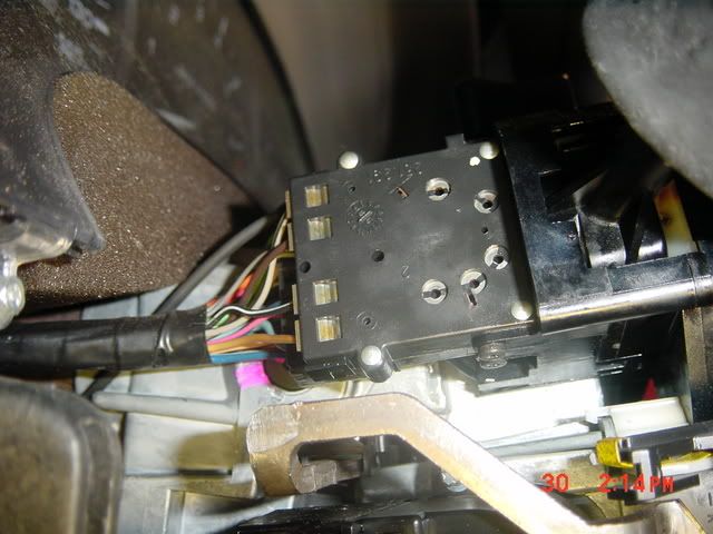

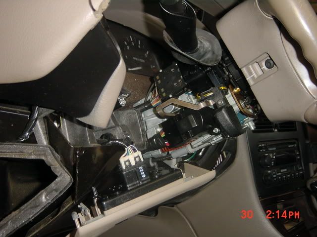

07-30-2005, 02:37 PM
thank you thumpin455 and all the others that have contributed to this thread. man oh man this fix really works. luckily i had contact cleaner and a compressor so it cost me basically nothing. and i like free, it's by far one of my favorite words. anyway, her is my contribution to this extremely helpfull thread. pics of the switch for reference.
http://i2.photobucket.com/albums/y9/jrc3/Dsc00024.jpg
http://i2.photobucket.com/albums/y9/jrc3/Dsc00023.jpg
good luck to all, jack
kiway22
01-24-2006, 01:08 AM
I was wondering what those contact holes looked like. I have read quite a few posts about them. Thx jrc3
