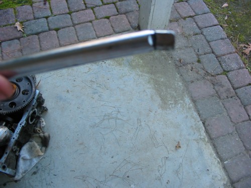

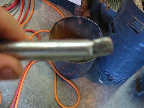

hah hah broken sockets, eh?
http://www.angelfire.com/nc3/punkalexspics/broken_001.jpg
http://www.angelfire.com/nc3/punkalexspics/broken_002.jpg
Those are two seperate extention bars i broke working on my car.....unfourtunately they were brand x and there was no warranty...Just one more reason to buy craftsman!
