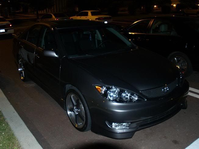

My 2005 SE had that same problem when it rained. It has the Ground Kit pakage that made it hold water better I guess. I also took a long object and openned the front door and started digging in the hole at bottom on both sides of the car and plenty of leaves and mud started to come out. After that, I had no problem with that slosh sound. Everytime you wash your car, clean out that area with a water hose and you should be ok. Hope that helped.
http://i232.photobucket.com/albums/ee34/fastdupree/My2ndCamrySE.jpg
