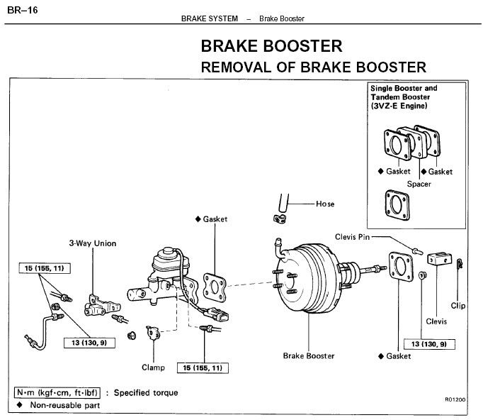

can anyone tell me if there is a Vacuum Brake Booster on a 93 PU with the 22RE? if so where is it, i know it isnt next to the master cylinder...

The brake booster is attached to the master cylinder unless it is different than my truck.

http://i16.photobucket.com/albums/b8/rogersb/Booster.jpg
