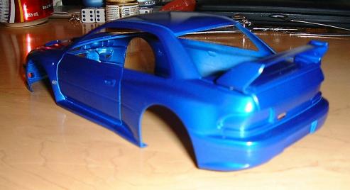

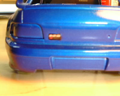

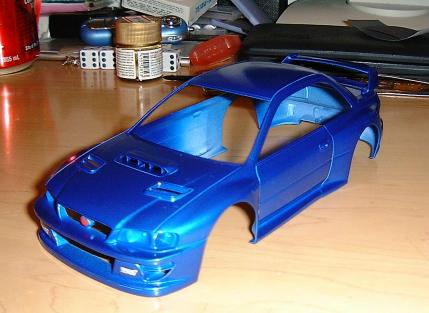

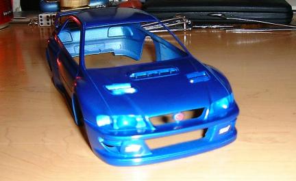

Tamiya's subaru rally car,impreza wrx'99, not just trying to make it into a road car but also make it looks like as 22b as possible ~~ give me some suggestions ~~ :grinno:

hum, i don't know if it can help to have a suby as close as 22b but david @ www.scaleracecars.com sells many transkit made by s27 to modify suby.

nice! i was looking for a 22b model but couldnt find one, so I thought about doing something like that as well sometime in the distant future. Your main concern will be to find/modify a different STI interior to match the 22b. The badge on the back you can either paint or photoetch or even just carve out of a small piece of styrene. Also, dont forget the 22b never came with a stereo so you will have to remove all traces of that if you want to retain authenticity. Lastly, you will have to find some 17in BBS rims and paint them in the same golden colour as the STi, as those were the specially made rims for the 22b.
dont forget the interior is two tone, black with blue inserts!

thanx ~ guys.. but finding a 17in BBS rims is hard ~~ geeeeez.. i was looking for aoshima's rim but i can't find it anywhere ~~~ it's all sold out ~ i have asked my aunt in jap... ask her to find me one.. but it's all sold out too ~~ :( . lastly ... the interior part... i was thinkin to use fujimi's interior .. but it doesn't seem fit on it, so gotta thinkin a way to figure out wut to do...

lookin good. only one thing-i think too many wrx's r blue-we need a grey one or a black one

I have prepared everything for converting a 22B and everything has been planned out. Excpet for the wheels.
I think the best donor car is the Hagesawa Impreza WRX sedan.
Its rear seat is a seperate piece from the interior tub, and its dash fits perfectly in the interior.
plus it has a center piece where the shiftknob and handbrake are located,
Its mirrors, unlike the fujimi ones, which only have a mirror set and not bases, come in as a complete piece with both mirror bases and connecting bases (like Tamiya WRX STI)
And add a 3rd LED brake light on the base mount of the rear spolier.

This is completely correct if one is trying to tackle this project's interior by fitting the tub onto tamiya's chasis. I was thinking of building the interior directly on the chasis. That race-filled floor could be covered by dark color coarse-grit sandpaper which, in my experience, is better simulating carpet than flocking (or better yet, Hasegawa WRX gives you a piece of carpet sticker), the rear seat is to be placed right on where package shelf and the seat meet, test-fitting shows this to be a good match. Dashboard and center console would sit very nicely in between the 2 door panels.
Biggest reason I am recommending this is that both Hagesawa's and Fujimi's door panels are SUPER flat and un-detailed, while Tamiya, even tho having gone through minor race-car mod, still stands out better-looking than other 2 brands.
I can snap a few photos upon request.
Moreover, in order to get the tub sitting on top of the chasis, the chasis needs to undergone a lot of cutting and sawing, which may not sound too good to some of us, including me.

here r some more updates .......... i didn't boost up the spoiler becuz it looks better the wrc way ...... but still ... i'll try to put the led brake light on.....

hey. looks nice
btw, how are you gonna make the 22b badge on the bootlid?
-Seb

u mean .. that ?? the resolution is not that high... so can't see too clear... but it actually came out good

i meant on the bootlid. theres a small badge saying
22B
Subaru Technica International
what was it you were showing me in the last pic? Note that you will also have to put the signal light on the top if thats what you were getting at.. :iceslolan
22B
