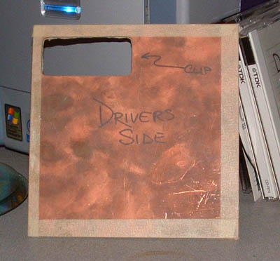

ci5ic
08-25-2003, 11:43 AM
When I wired mine up, I just used some regular old 16AWG wire with female spade-connectors. Basically, since I don't have bumper lenses anymore, I wired the bumper-lense wiring to the front half of the corner lenses so that they're only on when I use the turn-signal. I then wired the front-half of the corner lenses to the side-markers, so that the side-markers are on all the time (when the headlights are on).
Anyways, here's a kinda pic of that template:
http://files.automotiveforums.com/uploads/798527template.jpg
Here's a picture of the actual template which was made using a CNC router and some copper-clad fiberglass. Cardboard or something would work just as good, but I got bored at work:
http://files.automotiveforums.com/uploads/855802smRealTemplate.jpg
First, what I did was to put a layer of masking tape in the area of the fender where I was going to cut the hole. So, you can see in the first pic, there's a red arrow. Basically, what I did was to line that corner of the template up with the rubber side-molding, and the front edge of the door. Made sure that the bottom edge of the template was level with the molding. Then, I used a pen to mark the out-line of the hole onto the masking-tape on the fender. Once that was done, I used my dremel-tool and a cutting disc to cut the hole out. I stayed well within the outline I had drawn, because once you cut away, you can't put it back, so better to take it slow and make the hole smaller so you can grind away at it as needed.
So, once the hole was cut out, I'd test-fit the corner-lens, and see what needed to be ground out (also using the cutting disc seemed to work pretty good), and after several test-fits and some more grinding, it snapped right in.
Hope that helps...
And, FYI, the dimensions of the template are:
5 3/8" wide, 5 1/2" tall.
