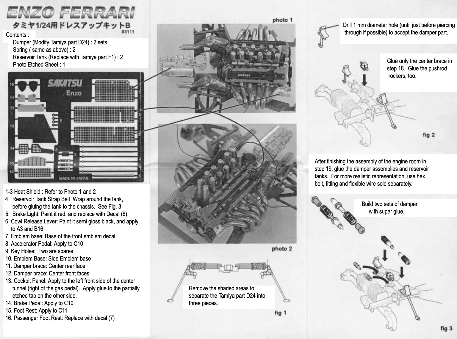

Paul the Greek
08-17-2003, 03:52 PM
Thanks, Hiroaki! Here is a good scan of the instructions. Let me know if you need a better one.
~~ Paul
Edited to add: Hmm, I can't see the image. Can anyone else? I attached it with the Attachment Manager.
hirofkd
08-17-2003, 06:17 PM
The image is too big for the forum, so I put it in my web space. Just save the target as..., or open in new window and save.
http://www.asahi-net.or.jp/~xr2h-fkd/temp/sakatsu-enzo-en.jpg
Any question or confusion due to my English,
please ask here, and I'll update the pic.
scaleracecars
08-17-2003, 06:24 PM
11 and 12 should be damper (shock) brace. Of course your English is much better than my Japanese. *smile*
Thanks. I needed this also!!
Paul the Greek
08-17-2003, 07:31 PM
Well Hiroaki, what can I say? Thanks a whole big bunch! And thanks for the corrections, SRC.
I can tell I'm gonna like this forum.
Thanks again, Hiroaki.
~~ Paul
