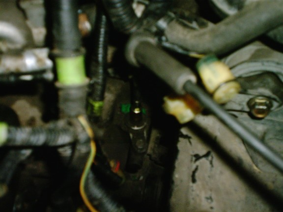

this is where the two-pronged plug is on the block, on the back
http://files.automotiveforums.com/uploads/313326AAAA0231.JPG

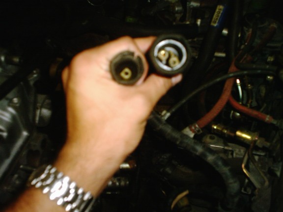

these are the two plugs on the harness. note the two plugs inside of the casing
http://files.automotiveforums.com/uploads/862215AAAA0232.JPG
one plug has a green and yellow wire, the other has a black wire
http://files.automotiveforums.com/uploads/351407AAAA0233.JPG
so does it matter which plug goes on which prong?
The single plug goes on the single prong, it is for the oil sending unit. The thing with 2 prongs is the Thermoswitch. When it senses your coolant is at a certain temp it completes the circuit between those 2 wires and turns on your fans. It does not matter which one goes on which prong.
that's what i wanted to hear :) i plugged them in and just crossed my fingers but now i know i'm good.
