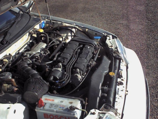

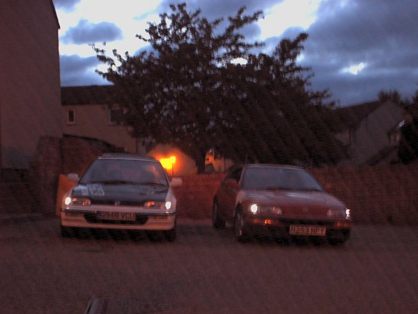

ian16v
08-04-2003, 11:57 AM
I know exactly what ur on about..., i done it to my civ. theres a resistor on the passenger side of the engine bay (well mine anyway, RHD) what it does is lower the voltage going to ur dip beam bulb. disconnect it.
it has a yellow sticker on it sayin this will get hot when sidemarkers are in use or suttin like that.... pics:
http://files.automotiveforums.com/uploads/314304enginebay.jpg
^old pic of bay
http://files.automotiveforums.com/uploads/580650sidelights.jpg
hope that helps!

JAMY
08-05-2003, 02:25 AM
YOUR THE MAN! Nice one mate, done the job a treat.
