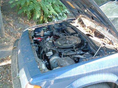

Just got a 86 or 87 crx for free :bigthumb:
Anyways, not sure what year it is, but it's badged as an Si... I thought that the Si's had EFI, but this one doesn't appear to be fuel injected...
My plans are either to make it full-on race (straight pipes, no cat, resonator, or muffler, etc.), or fix it up and sell it... or just sell it as is for a couple hundred.
What kind of engine swaps can I do on this? Would prefer direct bolt-in swap...
Anyways, here's some pics:

I guess it overheats, so I'll have to fix that...

Well, I'm a bit confused...
I'm used to the 4th generation civic terminology because I've been modding my 90 Si hatchback for a while now. So, when you say ZC, is it the same ZC for 4th gens? Or is there a 3rd gen ZC engine also? Plus, jackasssi mention in his post above that a ZC would be a direct bolt-in... If that's the ZC for the 4th-gens, wouldn't that mean that a 4th gen d-series engine would bolt right in as well (since I know that the 4G ZC engine bolts right into the d-series mounts in a 4th gen)?
Also, what is the clearance issue with the B18A1? Is it with the hood or the fire-wall or what? also, is the B18A1 the 86-87 teg motor?
I like the idea of getting the 86-87 teg motor... is that MPFI? What tranny would I need? What ECU would I need?
Anyone have any links to any engine-swap how-to's? I'm only interested in direct bolt-ins...

SO, if I got the teg ls (86-87) engine, what tranny should I use? The one from the teg?
Also, would I need the teg axles?
And, are you saying that the stock mounts won't work except for the driver-side engine mount?

use the ls tranny out of the 86-87 teg the one the motor came with.
you do need the axles and the intermediate shaft from the 86-87 teg yyou also need the hubs from the teg86-87.
the mounts from the crx you need the drivers side engine mount 86-87, andthe other 2 r from the teg 86-87.
the main problem i forsee is that your car is carberated, an you have to swicth some of your fuel system an some wiring.
RPR,Boman, LEW,and Gasoline Fumes may have a better discription of the things you have to do . I also would suggest RPR forum (Red Pepper Racing) but I have been unable to log on to it. I have a faq that had every thing you need but my old computer died a week ago an lost everything on it I hope this is helpin.
