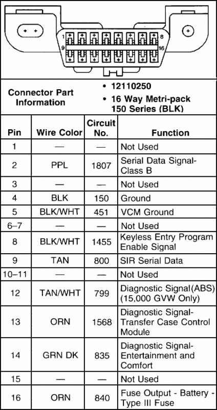

russn8r
09-21-2007, 11:05 PM
This would be easier if I knew what the Data Link Connector looked like. Anyone know where I can see a diagram or picture of the DLC for a 1999 Chevy Tahoe?

BigBlue77
09-21-2007, 11:45 PM
This is about the best pic and description I have found for the DLC. Its located on the drivers side under the dash.
