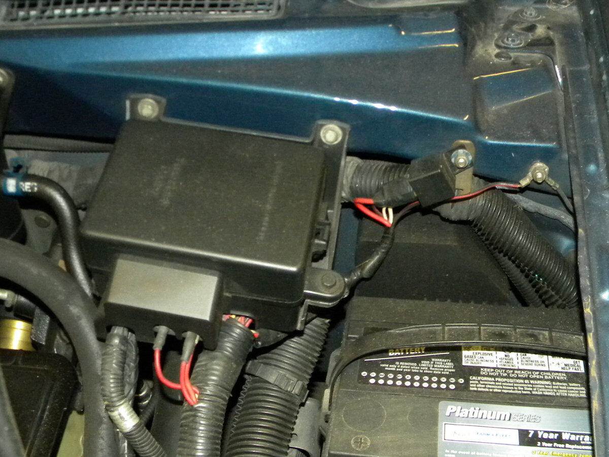

...I've never seen the FP relay be the issue- always the FP in my 35 yrs of testing.
You've been lucky. j cAT shows one example, I have two others with my OWN vehicles, not counting vehicles I service for others.
Here is the result of one - Having to install an auxiliary relay to handle the pump load due to the inability of the factory wiring to handle it reliably:
http://www.wwdsltd.com/files/262V6FPLoadRelay.jpg
