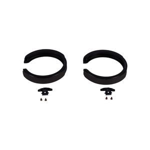

This is not uncommon. Almost any RWD from GM with rear disks made after the 1990s has a drum park brake. I have several examples, including B-body Impalas, S-10 trucks, and Envoy. The replacement rotors I've used all had the drum machined in the rotor hub.
https://contentinfo.autozonepro.com/znetcs/product-info/en/US/aim/55057/image/3
The rotor OEM part number is likely 19241878 or 88875212.
The harder part is finding the one-piece park brake shoe since not many places seem to stock them. As an example, AutoZone 55057 is shown as a replacement rotor, and they list the shoe as #781.
https://contentinfo.autozonepro.com/znetcs/product-info/en/US/epa/781/image/3/
The brake shoe part numbers are probably AC-DELCO 17771B, 14771B, or 88997309.
