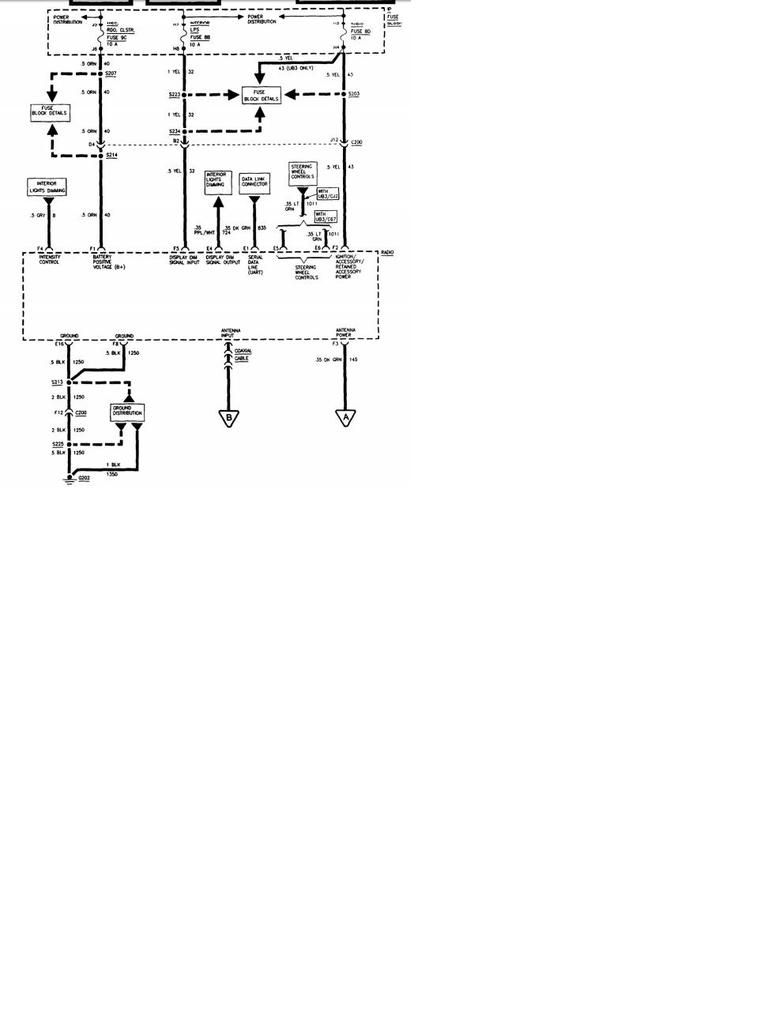

Seems like you are not getting the whole story here, if you were told a fuse was removed, and you find the radio not plugged in....
Here is a diagram for the power and ground in the harness to the radio to be checked out.......
http://i1208.photobucket.com/albums/cc376/gmtech7/LSradio.jpg
