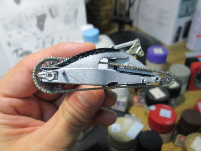

The swingarm
http://i124.photobucket.com/albums/p10/ace_f91/Repsol%20Honda%20RC213V%202014/swingarm%20angle%202_zps3gbokvw6.jpg (http://s124.photobucket.com/user/ace_f91/media/Repsol%20Honda%20RC213V%202014/swingarm%20angle%202_zps3gbokvw6.jpg.html)
http://i124.photobucket.com/albums/p10/ace_f91/Repsol%20Honda%20RC213V%202014/swingarm%20angle%201_zpso5mhangx.jpg (http://s124.photobucket.com/user/ace_f91/media/Repsol%20Honda%20RC213V%202014/swingarm%20angle%201_zpso5mhangx.jpg.html)
The work on the swingarm is really something different since the previous RC211Vs don't have black parts on the swingarm but this one really does. Took me a while to get it done & placing the absorber.

The swingarm

Adrian - the paint on the frame and swingarm looks very "grainy" is that the correct appearance for the frame and swingarm??
Look back in the completed models tab - LU did the first pictures of a completed 2014 Honda RC213V - compare your finish to his and see what I am talking of.
This is the first WIP for the RC213V so I do not know how LU painted his Marquez kit.

I did realized something wasn't right. Hobby spray cans here are kind of expensive these days and nowadays I do not have anymore kits to make. Hence, I have to make use of other types. Didn't think the spray can which was not used for a long time kind of made it look kind of 'grainy' or can i say 'sandy'? Or maybe I didn't shake enough? Hm.....
After so long didn't make any kits, I need to retrace back how I did the other bikes again. Most acrylic paints like I said earlier on are gone case.

Adrian - many times when a "spray can" of paint has been used and it has less that half of the propellant left to spray the paint from the can it will come out "grainy" like on your frame and swingarm.
Next time try to heat the can in sunlight for a while if it is warm and sunny outside - otherwise boil some water then remove the water from the stove and place the bottom of the spray paint can into the water to heat up the can.
This will expand the propellant gases and allow the paint to come out smoother
Also check the spray can "nozzle" where the paint comes out for dried paint build-up.
To keep the spray cans from "plugging" up when you have finished spraying - invert the can and press the spray button until it comes out "clear"
This will flush the paint from the "straw" inside and the "nozzle"
