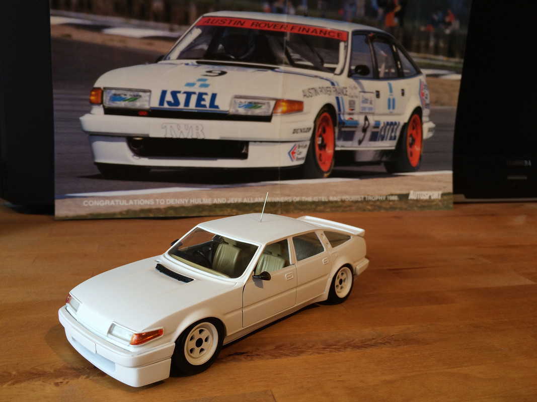

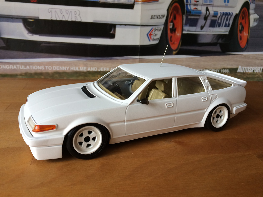

One of the best Group A touring cars in my opinion and I had to have a go at creating a scale version!
I have started with a 1:25 Polistil die cast road car and plan on modifying to create the TWR Group A racing version. So far I have made my own version of the Speedline 17 inch 5 spoke wheels, adjusted the sills which were incorrect and am in process of making later style front bumper and spoiler. I have also changed the shape of the rear windscreen because the early cars were straight across at the bottom, later ones were angled each side. Next step is the rear spoiler which is proving tricky to scratch build!
Photographs below show where I have got to so far. Hopefully get the rear spoiler completed tomorrow.
http://i38.photobucket.com/albums/e128/Viccario1/002.jpg (http://s38.photobucket.com/user/Viccario1/media/002.jpg.html)
http://i38.photobucket.com/albums/e128/Viccario1/010.jpg (http://s38.photobucket.com/user/Viccario1/media/010.jpg.html)
http://i38.photobucket.com/albums/e128/Viccario1/153.jpg (http://s38.photobucket.com/user/Viccario1/media/153.jpg.html)
http://i38.photobucket.com/albums/e128/Viccario1/167.jpg (http://s38.photobucket.com/user/Viccario1/media/167.jpg.html)
http://i38.photobucket.com/albums/e128/Viccario1/173.jpg (http://s38.photobucket.com/user/Viccario1/media/173.jpg.html)
http://i38.photobucket.com/albums/e128/Viccario1/170.jpg (http://s38.photobucket.com/user/Viccario1/media/170.jpg.html)
http://i38.photobucket.com/albums/e128/Viccario1/163.jpg (http://s38.photobucket.com/user/Viccario1/media/163.jpg.html)
http://i38.photobucket.com/albums/e128/Viccario1/164.jpg (http://s38.photobucket.com/user/Viccario1/media/164.jpg.html)
You may notice l have roughly drilled out 2 holes in one of the c pillars, these are for the air jack connection. Finally l have also cut out the rear number plate area so that l can make the fuel filler arrangement correctly.

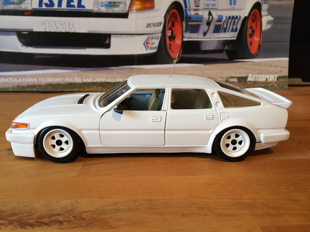

Rear spoiler completed except for some minor filling required. I have also filled in the gap in the rear panel below the rear lights with some styrene because it is continuous on the later cars. The photograph below is of the programme that I bought when I went to the race at Silverstone all those years ago!

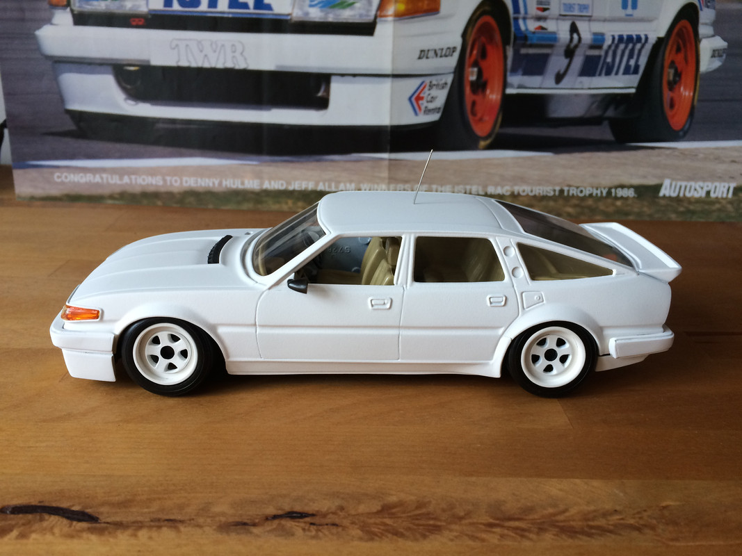

A little bit of progress. I wasn't happy with the rear windscreen glass that comes with the car because it does not fit flush as it does on the real car, (this can be seen in the photographs on the first page.) I have therefore made my own and had hoped to simply be able to lay it on top of the original glass. This didn't work very well because it would not sit correctly and I have had to cut out the original glass and replace it with my own version. Cutting out the original glass was very fraught because it was difficult not to damage the side windows. I also hoped that I might be able to still use the original version after I had cut it out but unfortunately it cracked during the removal process.
I have managed to get an interference type fit which should mean that i will be able to use a minimal amount of glue when permanently attaching to the body later. Next will be the rear bumper and rear wheel spats that locate in front of the rear arches.

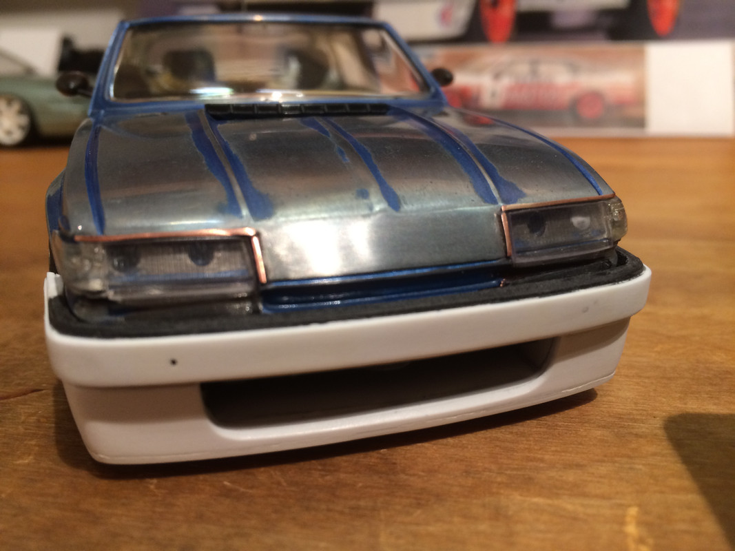

It's been a while but I have finally managed to complete a lot of the bodywork modifications including:
Creating a hole in the bonnet for the electrical cut off
Modifying the rear bumper to later version
Addition of the correct type of door mirrors in the window rather than the doors
Addition of the compressed air jacking cutouts to the C pillar on the passenger side
Addition of fuel filler and vent to rear of car where the number plate is normally located
Addition of recess to rear for boot hold down clips.
Completed creation of the spats that are positioned in front of the rear wheels
Addition of chrome surrounds around headlights completed using fuse wire
Modified headlights to later type.
Addition of hole in roof for radio aerial.
Completed white primer coat
Hopefully the photograph below works, it was taken a while ago and is not great quality. I hope to be able to add a number of better photographs in the next couple of days showing all of the progress so far.

Below shows start of creating the rear modified section that houses the fuel filler and vent.
https://i.postimg.cc/Kjtv703t/IMG-7900.jpg (https://postimg.cc/jndbtQXj)
https://i.postimg.cc/288SL78L/IMG-8171.jpg (https://postimg.cc/yWtHw9R7)
This one shows the fuse wire that I used to create the headlight surrounds.
https://i.postimg.cc/R08Mjkcc/IMG-8029.jpg (https://postimg.cc/GBFwDSg2)
Second coat of primer after lots of time consuming minor tweaks to fill imperfections etc.
https://i.postimg.cc/qqZV3nj2/IMG-8218.jpg (https://postimg.cc/WqrHRDR4)
https://i.postimg.cc/NMzp84vG/IMG-8216.jpg (https://postimg.cc/8JLRNLCx)
https://i.postimg.cc/rFx2md5R/IMG-8219.jpg (https://postimg.cc/Xpjz1YHn)

I'm pretty pleased with how it looks now, a lot more like the TWR version I think! Below show where I have got to so far. Next step is to start on the interior roll cage etc. which will be a challenge!
https://i.postimg.cc/YCMZCdpT/IMG-8233.jpg (https://postimg.cc/gntNMqLK)
https://i.postimg.cc/RFHXRtSc/IMG-8294.jpg (https://postimg.cc/yg7m6kSd)
https://i.postimg.cc/y8pjCjWm/IMG-8295.jpg (https://postimg.cc/0zmDppYj)

DasWiesel
05-08-2019, 03:55 PM
So nice to have this one back. I was afraid, you might have lost interest in that model.
Great progress so far! I would probably glue the front doors closed to get nicer and smaller panel lines.

Viccario
05-08-2019, 04:20 PM
Thanks for the comments DasWiesel l have actually glued the front doors shut already because the fit wasn't very good and to make sure that they aligned properly. The doors also scraped and damaged the paint when opened. I have also added additional material to the RHS driver's door to improve the shutline which you can see in some of the earlier photographs.
I did think about adding some more material to the other door but the fit is a lot better and I think when l darken the shutlines on the rear doors it will look ok. The photographs appear to exaggerate the difference because of the white primer l think.
