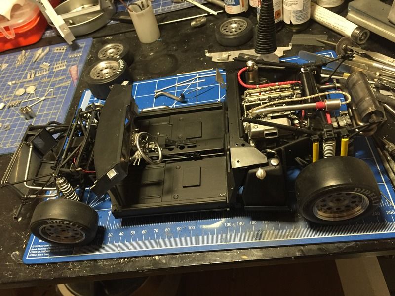

Remade the springs out of 1.5mm lighting cable.
Have now repainted the white.
They are now the right size.
http://i12.photobucket.com/albums/a210/puffyrs/front%201_zps5yxcuvhb.jpg (http://s12.photobucket.com/user/puffyrs/media/front%201_zps5yxcuvhb.jpg.html)
painted the frame.
http://i12.photobucket.com/albums/a210/puffyrs/front%202_zpswkpgwi4i.jpg (http://s12.photobucket.com/user/puffyrs/media/front%202_zpswkpgwi4i.jpg.html)
added pipes to brakes.
http://i12.photobucket.com/albums/a210/puffyrs/front%203_zpsvbvrbwcq.jpg (http://s12.photobucket.com/user/puffyrs/media/front%203_zpsvbvrbwcq.jpg.html)
Now working on the Rad.
in the kit you only get the spring in the black circle.
so will have to make another spring and fixings like in the white circle.
http://i12.photobucket.com/albums/a210/puffyrs/front%204_zpso8ntnltq.jpg (http://s12.photobucket.com/user/puffyrs/media/front%204_zpso8ntnltq.jpg.html)

puffyrs
11-02-2015, 02:53 PM
Still working on the front.
You have to keep building and checking and taking apart again.
Not all parts fit.
http://i12.photobucket.com/albums/a210/puffyrs/frame%203_zpsfconnb5o.jpg (http://s12.photobucket.com/user/puffyrs/media/frame%203_zpsfconnb5o.jpg.html)
Built the rad but you can see right through it so added some black plastic.
http://i12.photobucket.com/albums/a210/puffyrs/rad%202_zpsi8idgws5.jpg (http://s12.photobucket.com/user/puffyrs/media/rad%202_zpsi8idgws5.jpg.html)
added fan, still to add wiring.
http://i12.photobucket.com/albums/a210/puffyrs/fan%201_zps5wtqojfr.jpg (http://s12.photobucket.com/user/puffyrs/media/fan%201_zps5wtqojfr.jpg.html)
front end together still more parts to add.
http://i12.photobucket.com/albums/a210/puffyrs/fan%202_zpswsupthbi.jpg (http://s12.photobucket.com/user/puffyrs/media/fan%202_zpswsupthbi.jpg.html).
you cannot just build these out of the box. you have to check and recheck all the time.

sjelic
11-25-2015, 03:29 AM
Hi Martin
nice progress, doing the same kit, I am a bit further in process and since I was following your progress on that huge scratch build I assume you have a lot of references. One thing that is bothering me is location and look of ignition coil, because there isn't any in kit and on pictures I have you can't see the location of the coil. Do you have some picture or at least location, I assume it is on the left hand side wall close to volumex unit.
Thank you in advance and good luck with the kit.

lasagna99
11-25-2015, 04:40 AM
Nice work,Sjelic..
the coil was on the left side of the engine,in front of the Comprex compressor,fixed on the aluminium panel,where there were also the fuel pumps...
a hidden place...I know....

sjelic
11-25-2015, 04:22 PM
Great! Just what I needed, I suspected that it is somewhere there and it is simple design, no problem to schratch build.
Thanks Martin

sjelic
11-26-2015, 09:03 AM
Nice work,Sjelic..
Martin,very detailed and convincing work! :thumbsup:
Grazie Alessandro, I will skip the pumps since air filter blocks that part anyhow but coil is a must.
Thank you guys, you helped me a lot, sorry Martin for jumping in thread
