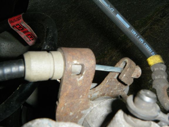

09-06-2015, 11:02 PM
The through caliper parking / "e" brake mechanism was frozen, got 2 new calipers. I removed the brake cable and the mechanism would not go to its "at rest" position.
http://i53.photobucket.com/albums/g80/viking_03/mechanism_zpsplv3ttnk.jpg
slls
09-07-2015, 01:45 PM
And that is one heavy spring, have you ever used the park brake?
