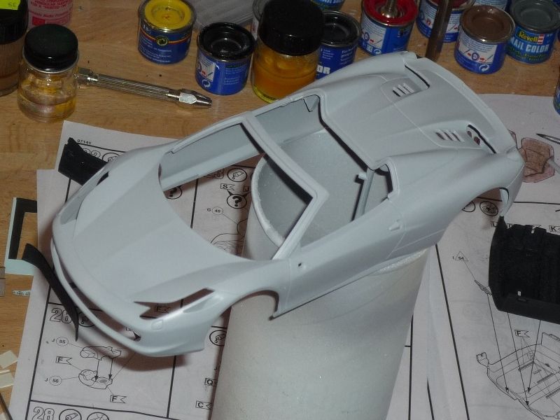

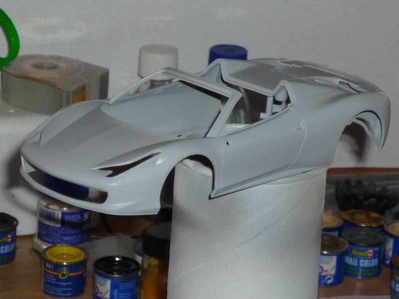

A quick mock up:
http://i1060.photobucket.com/albums/t459/kjenjak/P1080872_zpsnzehspoo.jpg

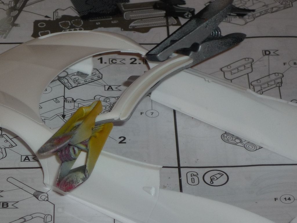

Some first work on the new A-pillars
http://i1060.photobucket.com/albums/t459/kjenjak/P1080878_zpsbnr5vkjj.jpg

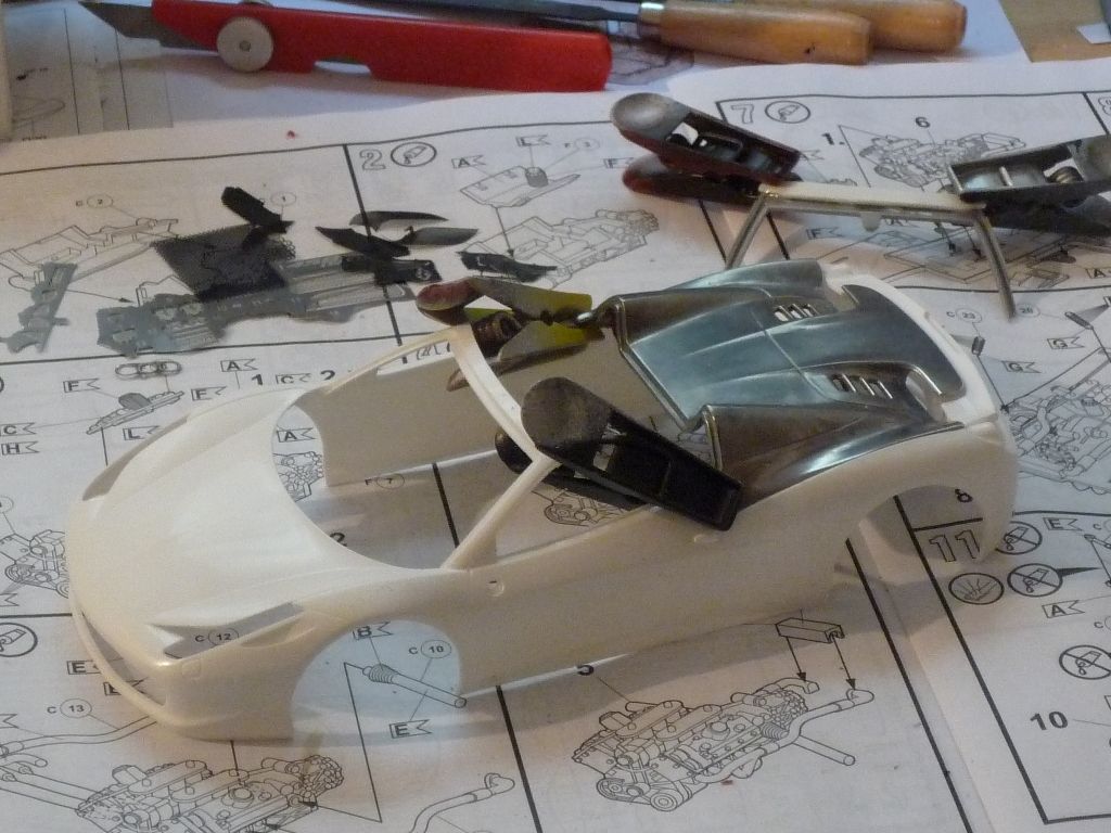

Engine cover is freed from its paint, and all air intakes and outlets have been opened. Now I need to figure out how to best attach the metal cover to the body, and fill the gaps.
http://i1060.photobucket.com/albums/t459/kjenjak/P1080881_zpsnecfdkzl.jpg
http://i1060.photobucket.com/albums/t459/kjenjak/P1080882_zpsypae08et.jpg

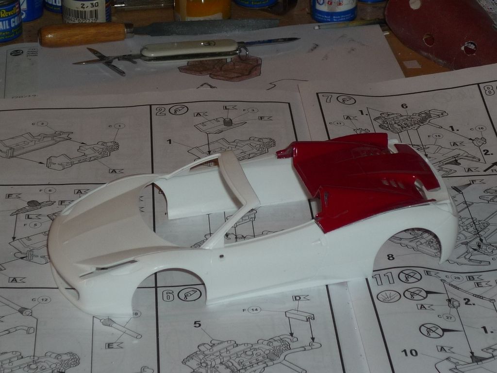

The engine cover is attached to the body. First I used some superglue to hold it in place, then I added 2K epoxy all around the joint on the inside of the body, backed with some pieces of sheet plastic, to strengthen the joint for things like sanding and polishing.
http://i1060.photobucket.com/albums/t459/kjenjak/P1080884_zps7ugjvlz1.jpg

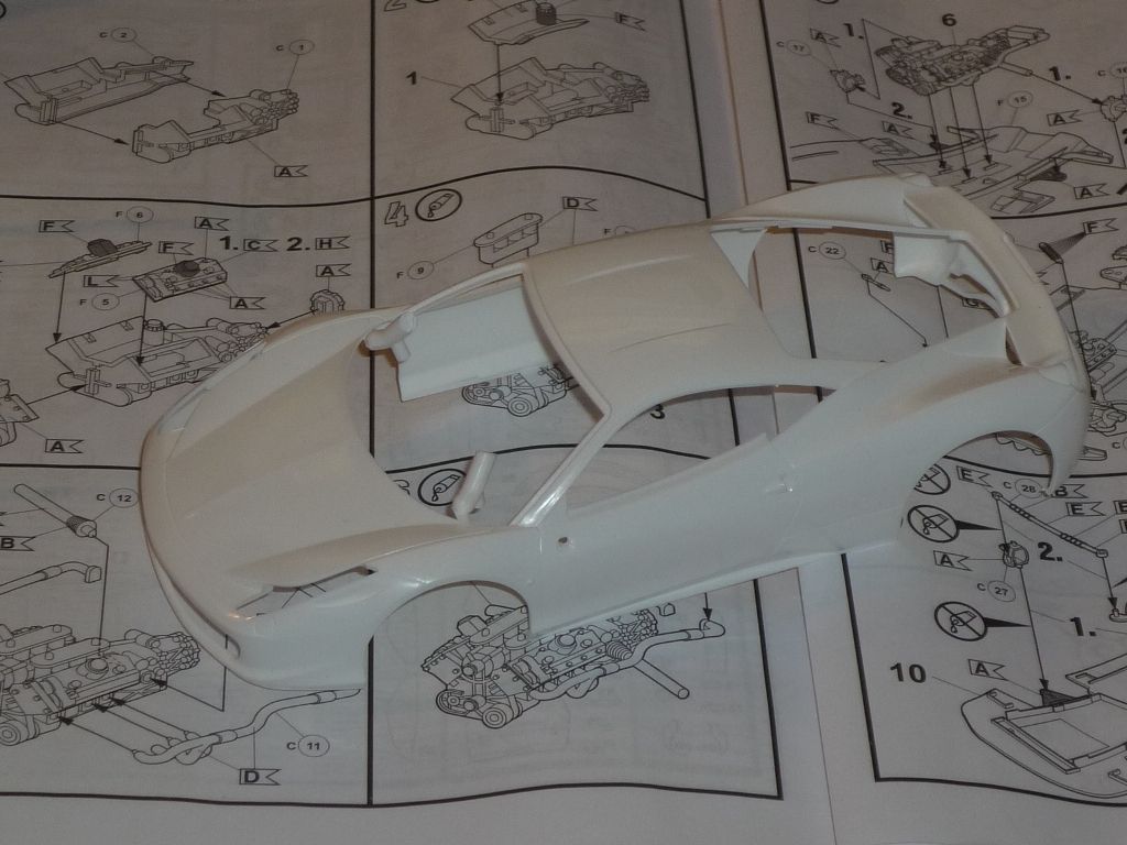

I've begun to fill the gaps on the outside with putty, priming to check for flaws, and reshaping the rear fenders to a nice round form. The new engine cover sits quite well on the body. Only the rear part of the lid has a slightly different angle than the plastic body, it faces down a little while the plastic is more or less horizontal, but I hope it won't be too obviously visible on the finished car.
http://i1060.photobucket.com/albums/t459/kjenjak/P1080886_zpsdiyropnz.jpg
