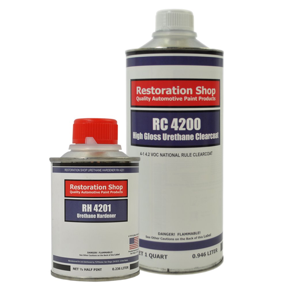

Tonio, what 2k product do you use ?
04-17-2015, 01:20 PM
http://www.amazon.com/Restoration-Shop-Urethane-Hardener-KIT-RC4200-QT/dp/B00BLBR9KQ/ref=sr_1_1?ie=UTF8&qid=1429291190&sr=8-1&keywords=restoration+automotive+clear
Restoration automotive clear. I just started using it recently.
http://ecx.images-amazon.com/images/I/61UGDcACbYL._SL1000_.jpg
