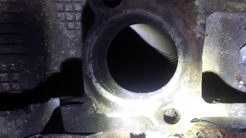

Now, once the manifolds are off, you'll see this:
http://img.photobucket.com/albums/v323/Slick_1/F250%20Manifolds/20141030_133334.jpg

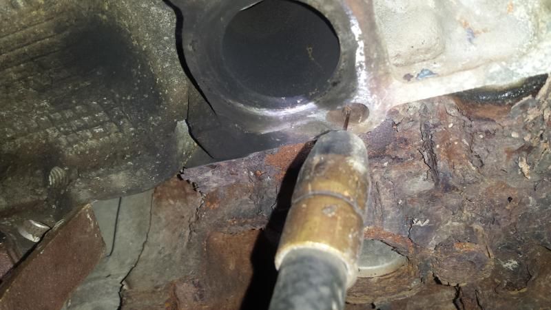

And now, you're thinking about the drill. But, this one might look easy
to get to, it's just the angle of the camera. But, the drill won't fit.
But...a wire feed welder will....
http://img.photobucket.com/albums/v323/Slick_1/F250%20Manifolds/20141030_133450.jpg

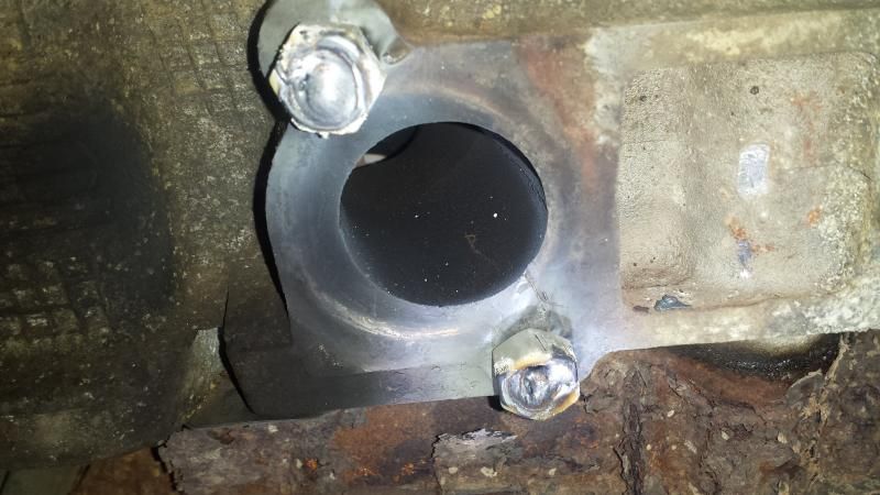

Now, make them look like this:
http://img.photobucket.com/albums/v323/Slick_1/F250%20Manifolds/20141030_133711.jpg

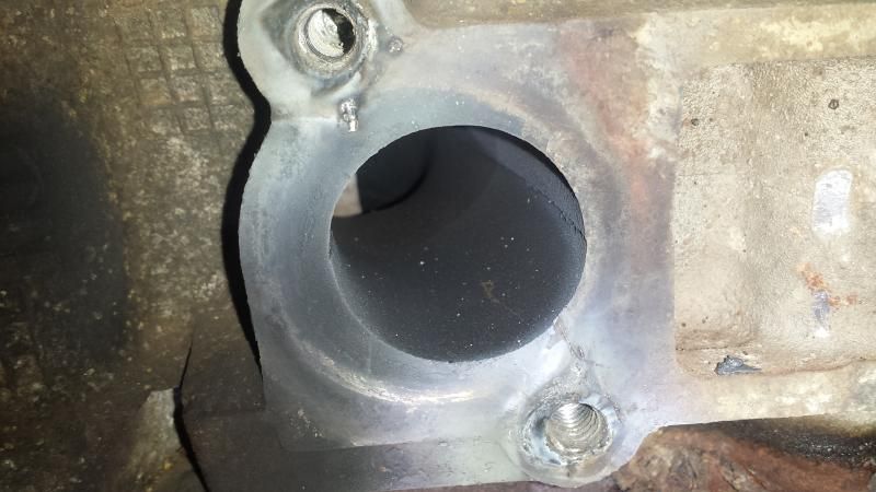

Don't be alarmed, the heads are aluminum. The studs are steel. The weld
will only stick to the studs. If it would do any damage to the threads, still
don't worry, because there is so much thread to lock onto beyond what
you could possibly damage. (By the way, no damage was done in my
particular instance)

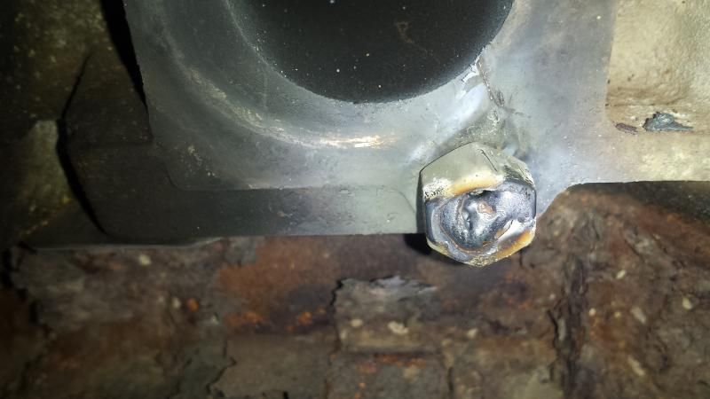

Next:
http://img.photobucket.com/albums/v323/Slick_1/F250%20Manifolds/20141030_133806.jpg

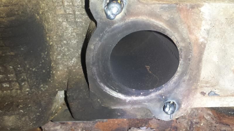

Then:
http://img.photobucket.com/albums/v323/Slick_1/F250%20Manifolds/20141030_134248.jpg
http://img.photobucket.com/albums/v323/Slick_1/F250%20Manifolds/20141030_134256.jpg

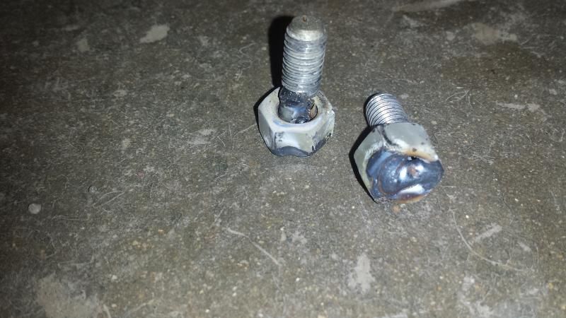

After you let them cool for about a minute (only until the red goes away),
then use a socket wrench to remove them. Not an impact, just use a
ratchet.
http://img.photobucket.com/albums/v323/Slick_1/F250%20Manifolds/20141030_134618.jpg

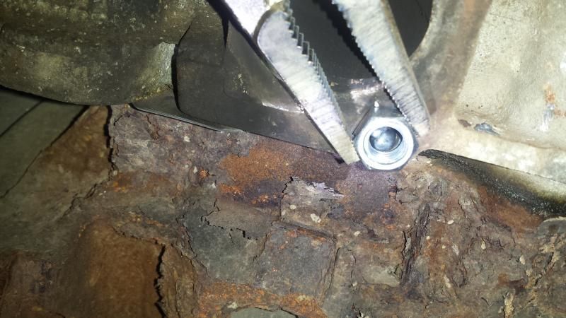

And here!
http://img.photobucket.com/albums/v323/Slick_1/F250%20Manifolds/20141030_134700.jpg
I've done this on quite a few vehicles, and it works every time.
