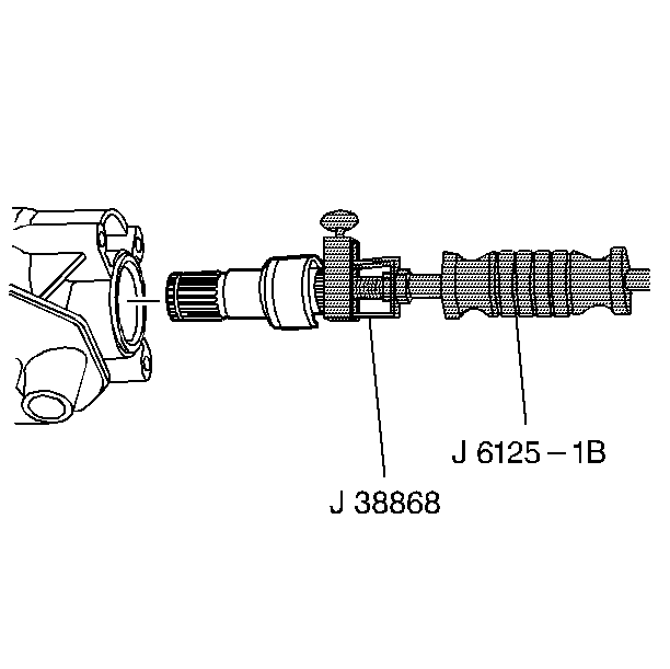

slls
06-17-2014, 03:34 PM
This is what the dealer is suppose to use.
http://i45.photobucket.com/albums/f98/gonogo/104556_zps6c61e952.png (http://s45.photobucket.com/user/gonogo/media/104556_zps6c61e952.png.html)
DeltaP
06-17-2014, 07:14 PM
Yeah, thats it! Thanks slls. But even with it you can still get a stubborn stub now and then.
