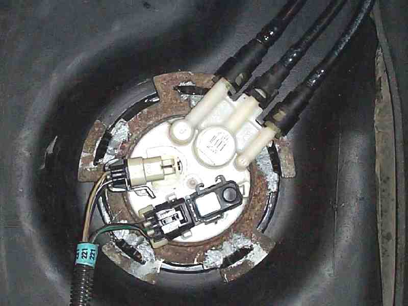

Also if u have any suggestions on this.... I bought this van 3 weeks ago and there was no gas cap and the fuel gauge is working backwards. I bought a cap and after using it for a day it started hesitating. Took the cap off and it about blew out of my hands so much pressure in the tank. Checked the lines underneath. One had a clamp they did not get over the hose at the nipple was actually pinching the line closed. I believe that was the vent line. Problem has still not gone away. So I am going to find out what's up. I did get a new code P000452 which is the tank pressure sensor.
if you have any suggestions for that I would appreciate it. Thanks Mike.
Blue Bowtie
05-16-2014, 06:58 PM
Between the vent/purge, return, and pressure lines on the tank, only the return and vent/purge lines could possibly be reversed since the fittings are the same size. This is what the tank top unit looks like:
http://www.wwdsltd.com/files/AstroTankTopUnit.jpg
Unfortunately, the only way to get to it is to drop the tank. I've been there several times on my Astro for the connector, a pump, and a fuel level sender, and then a second pump.
