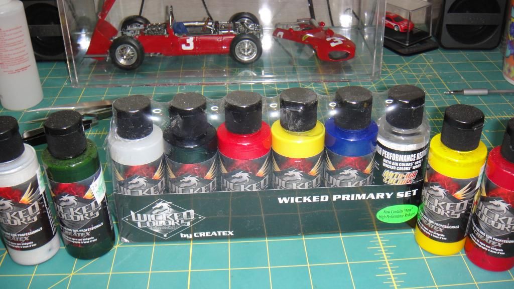

So I was at hobby lobby. and saw this paint and it was on sale so I picked it up. I have never used it so was wondering if anyone here has, and if its any good. I have a few cheap kits I might try it on first. if you have used it what primer have you used for it.

Those are supposed to be very good paints, so I think you may have gotten yourself a bargain .

Can you actually use these on 1/24 bodies? Like... with good results?

them on last 2 builds. So I have used wicked opaque white and wicked blue. they leave orange peel which could be me but at the same time I sprayed model masters ,Tamiya, and alclad and none of them did. also the dry semi-gloss. no big deal if you cover with clear coat. It says ready to handle after 30 mins but even a day later paint still feels soft. I used Tamiya and krylon primers with it. at this point cant say if they are good or not give me a few builds.
