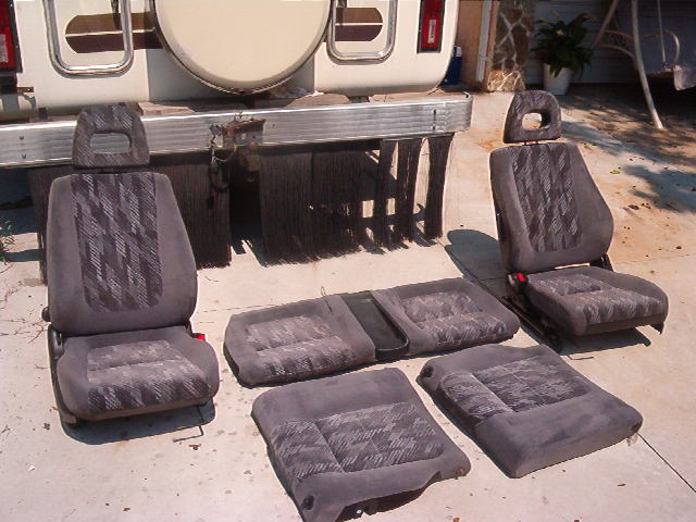

here is the 96 teg seats i scored as well. this is right after i cleaned them.
http://files.automotiveforums.com/uploads/420239Picture3003.jpg
let me know what you guys think

did the rears fit in? i got a full set of all four 91 teg LS seats, i made the front ones fit and i'd like to make the back ones fit too because they are mint condition. the only thing though is the rear seat bottom is a couple inches too wide, i'd have to rig it up. just wondered if you had the same problem with newer seats?

i havnt had a chance to fit the rear seats yet or the front ones. i have been cleaning them all day and installing the center console, but i will update on that in a little bit. and the only carbon fiber accent i have is that ricey e brake handle which i dont want anymore. i forgot to get the stock one from the junk yard.

i didnt trim anything at all, just took the old one out and separated the one peice. then what i did was i put the peice for my radio on first and the center peice on and lined everythingup and put a bolt on each side. the i slde the arm rest section on and drilled some new holes for that and everything lines up awesome. i was easier then i expected. will it be hard to install the integra seats??

I have 90 LS seats in my civic, in order to make them fit i had to chop the front mounting brackets off, and bolt the civic brackets on. it will bolt on after that, but you'll notice the seats sit at a gay angle, so what i had to do was elongate the outer rear hole in a verticle fasion, and then elongate the inner rear bracket lengthways and use about 8 big washers on the inner bolt as well as use a longer bolt. now they sit straight.

i think i am just going to keep my seats that are in there now. i dont feel like messing around with all that. so i guess its off to ebay with the seats!!
