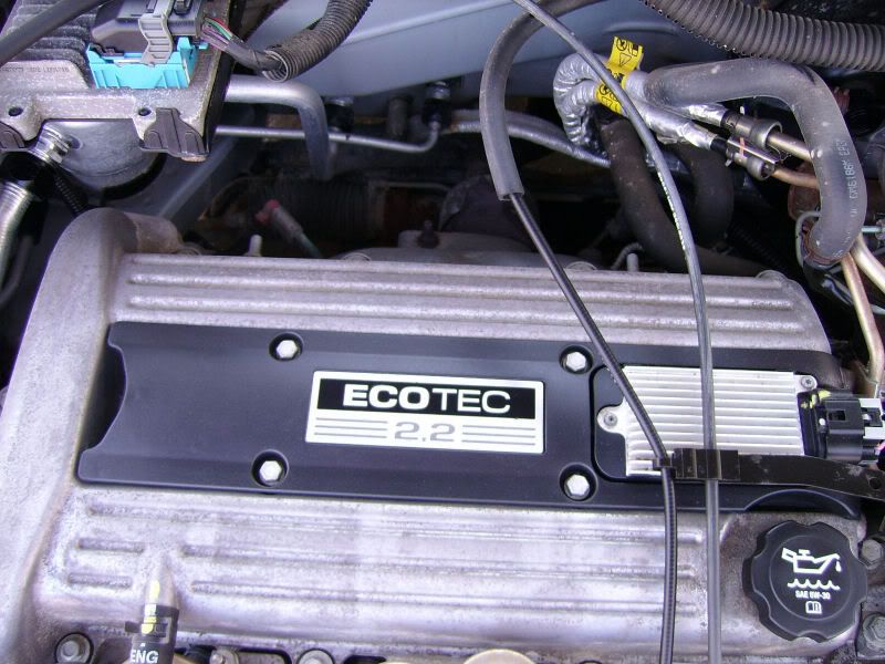

i am really concidering buying a new 03 ecotec engine, but i can't seem to find one. also which would be better a brand new ecotec engine or a used z24 engine. if i get the ecotec engine i was planning on putting in a turbo or a supercharger. which would be a better or cheaper way to go.

If you can find one, the ecotec is probably a better choice. It is a much more refined engine and despite having 10 less horse than the 2.4, it is just as fast. The ecotec is an all aluminum chain-driven system and weighs only 300 lbs. I don't think that those 10 ponies from the 2.4 will be missed. I speak from personal experience because my last car was a 99 z24. Anyway, if you plan on doing mods it wont matter. Scrap yards are your best bet. There isn't too much on the net in terms of whole engines. Don't go to a u-pull-it scrap yard because those engines are usually stripped of all the goodies. I just bought a 3.1 for my 88Z24 that only had 40000 miles on it and that came out of a 1990. Front drive GM motors are a dime a dozen ( a great thing about owning an american car). The good thing is that regardless of what you choose, 2.2 ecotec, or 2.4, this engine is easy to find in a junk yard. This engine is shared in the Z24, grand am, alero, pontiac sunfire gt and probably a few others. It should be a piece of cake to find. Granted the 2.4 will be easier because it has been used for the past 6 years. Check out this link on the ecotec though. Maybe it will help you out:

i agree w/ mdb25 ^, the ecotec is a much better and faster engine. mods for the 2.4 and ecotec are the same--turbo, supercharger, nos, and many other bolt on parts; overall, the ecotec is the way to go.

Yes, the 2.4 does have a little more hp and its a little torqier, but it weighs almost twice as much. Where do you see the gain? I wouldn't trust the numbers you read, they differ from magazine to magazine. Take it from me, I owned a 99Z with a 2.4 5speed and I now own a 02 LS sport with a 2.2 ecotec 5speed. The 99 is not faster. It roared a little bit more off the start and had a slightly torquier feel while the ecotec is very swift and much more silent. I'm not trying to turn this into a debate, but I know what I'm talking about because I have owned both engines. The 2.4 is definetely a sweet motor, but in comparison to the ecotec, it is more raucous and much heavier. The weight loss in the ecotec makes up for the 10 lost horse.

I am also starting on an Ecotec project right now. I have a 2.2/5spd from an 02 Cav Z24. That I am putting into my 92 Beretta GTZ.

the eco-tec is an aluminum block???? jeez......now I want one too :bigthumb:

I am inquiring as to what it would take to retrofit a 2.2L Ecotec into a '94 Pontiac Sunbird LE sedan.
I have heard that I would have to change motor mounts, and I also know that I would have to have OBD-II-compliant electronics installed under the hood.
My main question is what modifications would I have to make to my fuel tank? I have heard that OBD-II powerplants are REALLY finicky when it comes to gas caps.
Any help and advice would be greatly appreciated!!!

just posten some pics of my engine but, no its not for sale...
